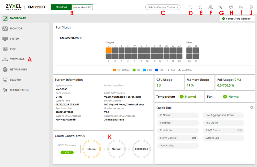

Web Configurator
*In Cloud mode, the settings you configure in the Web Configurator will apply to the Switch but will not appear in the Nebula settings. The settings you configure in Nebula will overwrite the Web Configurator settings. It is the latest settings that will apply to the Switch.
*To avoid inconsistency, we recommend you use Nebula to configure the Switch and only use the Web Configurator for troubleshooting.
System Login
1 Start your web browser.
2 The Switch is a DHCP client by default. Type “https://DHCP-assigned IP” in the Location or Address field. Press [ENTER].
*You can always use the domain name “setup.zyxel” to access the Web Configurator whether the Switch is using a DHCP-assigned IP or static IP address. This requires your computer to be directly connected to the Switch. Make sure your computer can connect to a DNS server through the Switch.
If the Switch is not connected to a DHCP server, type “https://” and the static IP address of the Switch (for example, the default management IP address is 192.168.1.1 through an in-band port) in the Location or Address field. Press [ENTER]. Your computer must be in the same subnet in order to access this website address.
Also, you can use the ZON Utility to check your Switch’s IP address.
3 If a “Your connection is not private” screen appears, click Advanced and Proceed to DHCP-assigned IP (unsafe) to go to the Login screen. This screen appears as the Zyxel Device uses a certificate for the HTTPS connection. See Section 77.2 on page 551 for information on using an HTTPS certificate verified by a third party to create secure HTTPS connections between your computer and the Switch.
*If you see this warning page, it indicates that your browser has failed to verify the Secure Sockets Layer (SSL) certificate, which opens an encrypted connection. You can ignore this message and proceed to the login IP address.
The Login screen appears.
4 In Standalone mode, click the Visit Nebula button if you want to open the Zyxel Nebula Control Center (NCC) login page in a new tab or window. In Cloud mode, click the Go Now button. The NCC is a cloud-based network management system that allows you to remotely manage and monitor the Switch. See Section 1.4.1 on page 35 for information on changing your Switch to Nebula Cloud management.
5 Alternatively, click Login to log into the Web Configurator to manage the Switch directly.
In Standalone mode, the default user name is admin and associated default password is on the label on the bottom of the Switch.
In Cloud mode, use the Local credentials: password to login. The Local credentials: Password can be found in Site-wide > Configure > Site settings > Device configuration in the NCC portal. See the NCC User’s Guide for more information.
In Standalone mode, the change password screen appears the first time you log in using the default password.
*The allowed string length is 4 to 32 for the new password and should not contain [ ? ], [ | ], [ ' ], [ " ], [ , ], [ [ ], [ ] ], or [ space ].
6 After setting the new password, close and restart your web browser. Enter the ‘https://DHCP-assigned IP’ in the URL field and press [ENTER]. When the login screen appears, enter the user name (default: ‘admin’) and new password.
When in Standalone mode, the Select Mode screen appears.
7 Select the Web Configurator in Standard Mode that has a complete set of configuration for network installation. Or select the Web Configurator in Networked AV Mode that has a set of menus specifically designed to simplify configuration and management of the Switch for AVoIP (Audio-Video over Internet Protocol) application.
8 The Setup Wizard screen will appear after selecting the Networked AV Mode. You can use the Setup Wizard screen in Networked AV mode to configure the Switch’s Networked AV mode’s basic or advanced settings (see Networked AV Mode Wizard for details).
Use the Basic Settings to configure networked AV operation on management VLAN. Such as the Switches’ IP address, DNS server, system password, SNMP community, accept or skip the default Networked AV mode settings, and view a summary of the basic settings.
Use the Advanced Settings for networks that wants to separate networked AV VLAN from management VLAN, specify which ports connect to AVoIP application, and for setting link aggregation across switches.
Once you click the Finish button, the settings configured in the Setup Wizard screen will overwrite the existing settings.
Otherwise, click the Exit button. If you want to open the Setup Wizard screen later, click the Wizard icon in the upper right hand corner of the Web Configurator in Networked AV mode.

Web Configurator Layout
The DASHBOARD screen is the first screen that displays when you access the Web Configurator.
The following figure shows the navigating components of a Web Configurator screen.
A Click the menu items to open sub-menu links, and then click on a sub-menu link to open the screen in the main window.
B, C, D, E, F, G, H, I, J, K These are quick links which allow you to perform certain tasks no matter which screen you are currently working in.
B Click this icon to switch between the Web Configurator’s Standard or Networked AV mode.
C Click this icon to go to the NCC (Nebula Control Center) portal website.
D – Click this icon to search for specific configurations or status you are looking for. Enter the keywords and click the result link. This will direct you to the specific configuration or status page.
E – Click this icon to update the information in the screen you are currently viewing.
F Click this icon to save your configuration into the Switch’s non-volatile memory. Non-volatile memory is the configuration of your Switch that stays the same even if the Switch’s power is turned off.
G Click this icon to display the Setup Wizard that contains the Basic, Protection, VLAN, and QoS setup screens.
H Click this icon to display web help pages. The help pages provide descriptions for all of the configuration screens.
I Click this icon to go to the Zyxel Community Biz Forum.
J Click this icon to log out of the Web Configurator.
K This displays the Nebula Cloud Control Status. The ON/OFF switch displays if NCC Discovery is enabled. If a status circle turns Orange, it means the Switch is unable to connect to NCC. Hover the mouse over the status circle to check the diagnostic message. You can also click the ON/OFF switch to go to the SYSTEM > Cloud Management > Cloud Management screen and check the diagnostic messages. See Table 47 on page 158 for more information.

Save Your Configuration
When you are done modifying the settings in a screen, click Apply to save your changes back to the run-time memory. Settings in the run-time memory are lost when the Switch’s power is turned off.
Click the Save link in the upper right of the Web Configurator to save your configuration to non-volatile memory. Non-volatile memory refers to the Switch’s storage that remains even if the Switch’s power is turned off.
*Use the Save link when you are done with a configuration session.
Switch Lockout
You could block yourself (and all others) from managing the Switch if you do one of the following:
1 Delete the management VLAN (default is VLAN 1).
2 Delete all port-based VLANs with the CPU port as a member. The “CPU port” is the management port of the Switch.
3 Filter all traffic to the CPU port.
4 Disable all ports.
5 Misconfigure the text configuration file.
6 Forget the password and/or IP address.
7 Prevent all services from accessing the Switch.
8 Change a service port number but forget it.
9 You forgot to log out of the Switch from a computer before logging in again on another computer.
*Be careful not to lock yourself and others out of the Switch.
Restoring the Switch to the Factory Defaults
If you lock yourself (and others) from the Switch or forget the administrator password, you will need to restore the Switch back to the factory defaults.
Reboot the Switch
Press the RESET button to reboot the Switch without turning the power off. See Section 3.4 on page 56 for more information about the LED behavior.
Log Out of the Web Configurator
Click Logout in a screen to exit the Web Configurator. You have to log in with your password again after you log out. This is recommended after you finish a management session for security reasons.
Logout button
