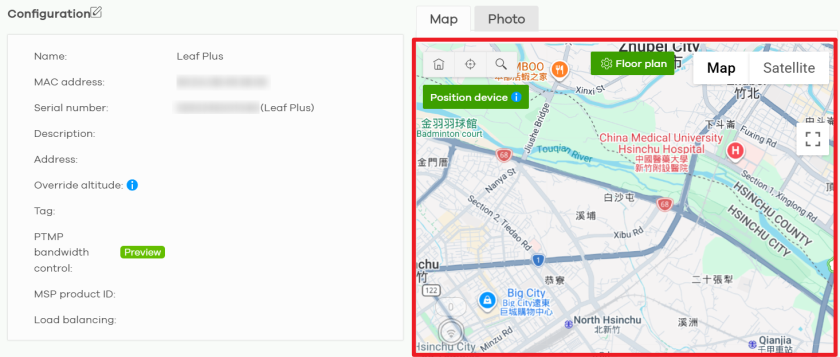

My Leaf Plus cannot display properly in the NCC map.
If the Leaf Plus GPS signal is unavailable or weak, it may not display properly in the NCC map (Site-wide > Devices > Access Points).
To obtain a stronger GPS signal, try the following:
• Avoid nearby buildings, walls, trees, or other objects that may block GPS signals.
• Wait a few minutes after power-on for the Leaf Plus to obtain GPS information.
