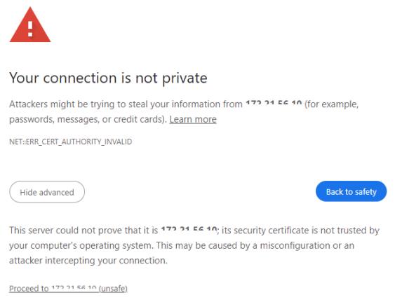

3 If a “Your connection is not private” screen appears, click Advanced and Proceed to DHCP-assigned IP (unsafe) to go to the Login screen. This screen appears as the Zyxel Device uses a certificate for the HTTPS connection. See Section 77.2 on page 549 for information on using an HTTPS certificate verified by a third party to create secure HTTPS connections between your computer and the Switch.
*If you see this warning page, it indicates that your browser has failed to verify the Secure Sockets Layer (SSL) certificate, which opens an encrypted connection. You can ignore this message and proceed to the login IP address.
Unsafe Login Warning

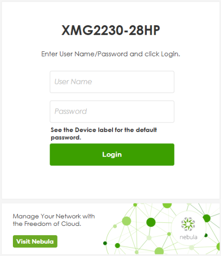

The Login screen appears.
Web Configurator: Login (Standalone mode)

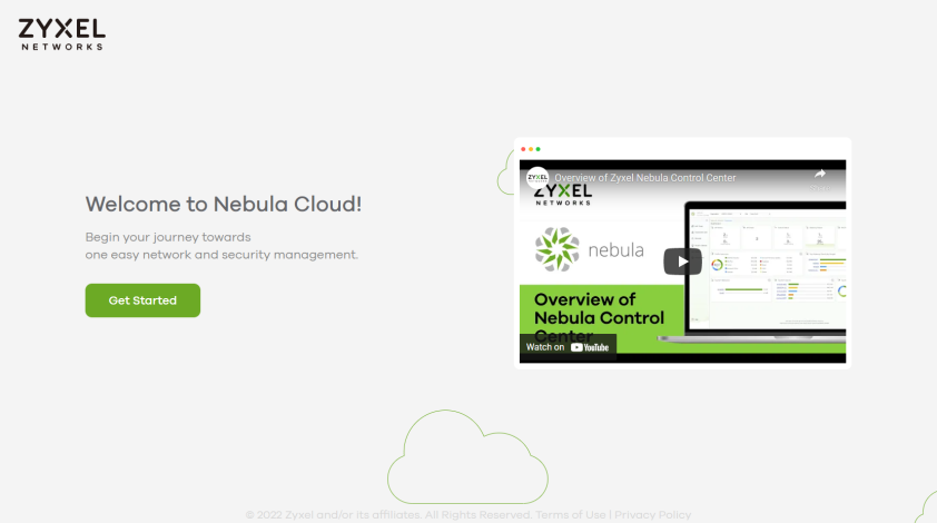

4 In Standalone mode, click the Visit Nebula button if you want to open the Zyxel Nebula Control Center (NCC) login page in a new tab or window. In Cloud mode, click the Go Now button. The NCC is a cloud-based network management system that allows you to remotely manage and monitor the Switch. See Section 1.4.1 on page 35 for information on changing your Switch to Nebula Cloud management.
Visit Nebula
5 Alternatively, click Login to log into the Web Configurator to manage the Switch directly.
In Standalone mode, the default user name is admin and associated default password is on the label on the bottom of the Switch.
In Cloud mode, use the Local credentials: password to login. The Local credentials: Password can be found in Site-wide > Configure > Site settings > Device configuration in the NCC portal. See the NCC User’s Guide for more information.

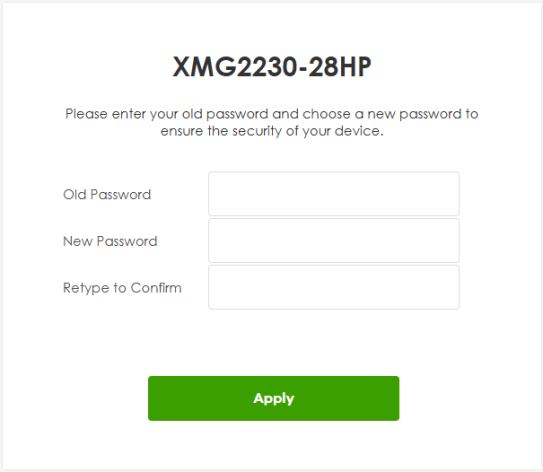

In Standalone mode, the change password screen appears the first time you log in using the default password.
*The allowed string length is 4 to 32 for the new password and should not contain [ ? ], [ | ], [ ' ], [ " ], [ , ], [ [ ], [ ] ], or [ space ].
Change Password Screen

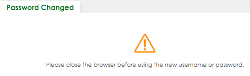

6 After setting the new password, close and restart your web browser. Enter the ‘https://DHCP-assigned IP’ in the URL field and press [ENTER]. When the login screen appears, enter the user name (default: ‘admin’) and new password.
Password Changed Screen

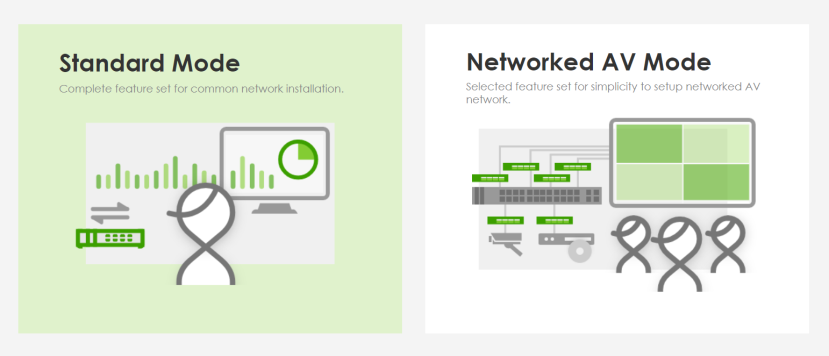

When in Standalone mode, the Select Mode screen appears.
Select Mode
7 Select the Web Configurator in Standard Mode that has a complete set of configuration for network installation. Or select the Web Configurator in Networked AV Mode that has a set of menus specifically designed to simplify configuration and management of the Switch for AVoIP (Audio-Video over Internet Protocol) application.

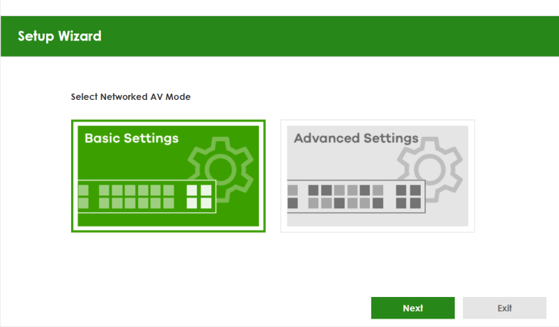

8 The Setup Wizard screen will appear after selecting the Networked AV Mode. You can use the Setup Wizard screen in Networked AV mode to configure the Switch’s Networked AV mode’s basic or advanced settings (see Networked AV Mode Wizard for details).
• Use the Basic Settings to configure networked AV operation on management VLAN. Such as the Switches’ IP address, DNS server, system password, SNMP community, accept or skip the default Networked AV mode settings, and view a summary of the basic settings.
• Use the Advanced Settings for networks that wants to separate networked AV VLAN from management VLAN, specify which ports connect to AVoIP application, and for setting link aggregation across switches.
Once you click the Finish button, the settings configured in the Setup Wizard screen will overwrite the existing settings.

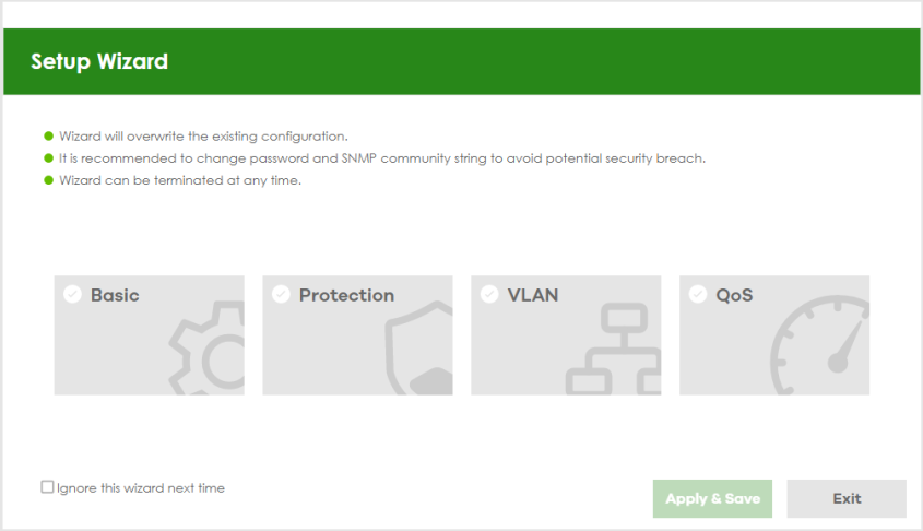

Web Configurator: Wizard (Standard Mode)
Otherwise, click the Exit button. If you want to open the Setup Wizard screen later, click the Wizard icon in the upper right hand corner of the Web Configurator in Networked AV mode.

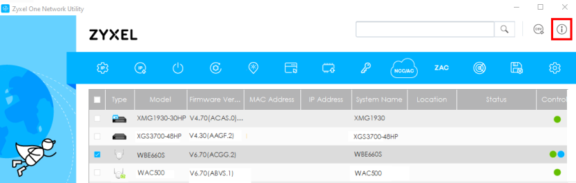

Run the ZON Utility

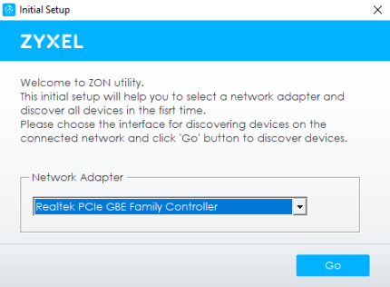

1 Double-click the ZON Utility to run it.
2 Select a network adapter to which your supported devices are connected.
Network Adapter
3 Click the Go button for the ZON Utility to discover all supported devices in your network.
Discovery
4 The ZON Utility screen shows the devices discovered.
ZON Utility Screen

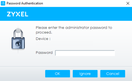

5 Select a device and then use the icons to perform actions. Some functions may not be available for your devices.
*You must know the selected device admin password before taking actions on the device using the ZON Utility icons.
Password Prompt

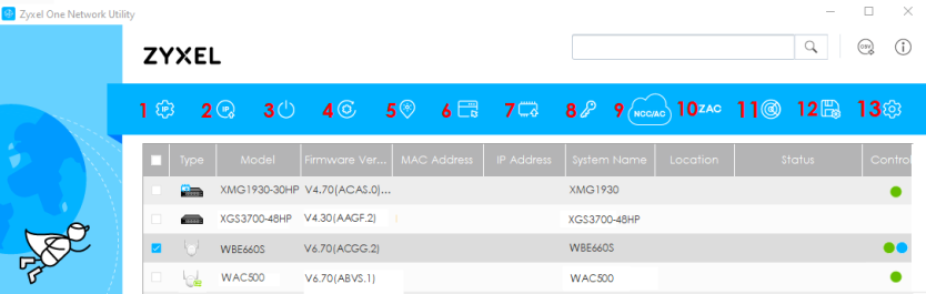

The following table describes the icons numbered from left to right in the ZON Utility screen.
ZON Utility Icons
icon
DESCRIPTION
1 IP Configuration
Change the selected device’s IP address.
2 Renew IP Address
Update a DHCP-assigned dynamic IP address.
3 Reboot Device
Use this icon to restart the selected devices. This may be useful when troubleshooting or upgrading new firmware.
4 Reset Configuration to Default
Use this icon to reload the factory-default configuration file. This means that you will lose all previous configurations.
5 Locator LED
Use this icon to locate the selected device by causing its Locator LED to blink.
6 Web GUI
Use this to access the selected device Web Configurator from your browser. You will need a user name and password to log in.
7 Firmware Upgrade
Use this icon to upgrade new firmware to selected devices of the same model. Make sure you have downloaded the firmware from the Zyxel website to your computer and unzipped it in advance.
8 Change Password
Use this icon to change the admin password of the selected device. You must know the current admin password before changing to a new one.
9 Configure NCC Discovery
You must have Internet access to use this feature. Use this icon to enable or disable the Nebula Control Center (NCC) discovery feature on the selected device. If it is enabled, the selected device will try to connect to the NCC. Once the selected device is connected to and has registered in the NCC, it will go into the Nebula cloud management mode.
10 ZAC
Use this icon to run the Zyxel AP Configurator of the selected AP.
11 Clear and Rescan
Use this icon to clear the list and discover all devices on the connected network again.
12 Save Configuration
Use this icon to save configuration changes to permanent memory on a selected device.
13 Settings
Use this icon to select a network adapter for the computer on which the ZON utility is installed, and the utility language.
The Setup Wizard can be accessed using the following methods:
• When the Switch is in its factory-default state, selecting Networked AV mode will automatically access the Setup Wizard.
• When in Networked AV mode, click the Wizard link to access the Setup Wizard.
Wizard Link in Networked AV Mode
The Setup Wizard contains the following parts:

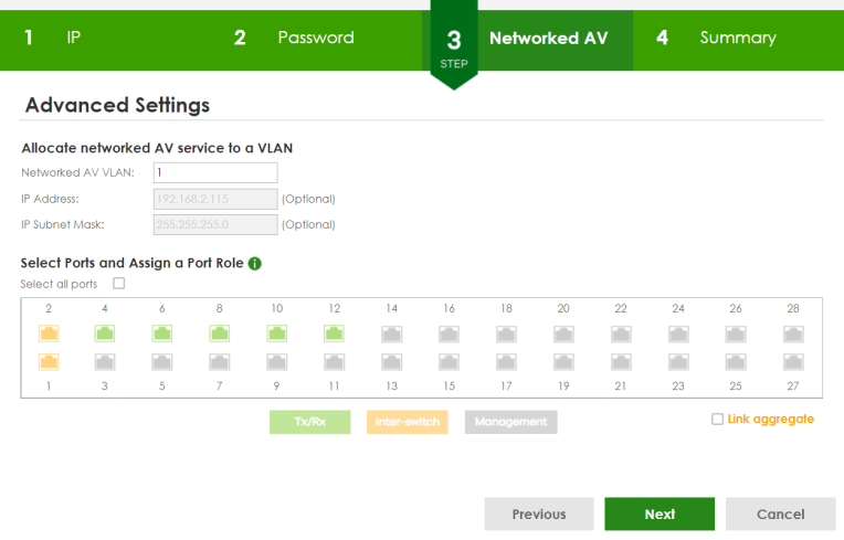

• Use the Basic Settings when networked AV service runs on management VLAN, using the combo/fiber port for inter-switch connection.
• Use the Advanced Settings when you need to specify the VLAN for networked AV service and configure the port’s role manually.

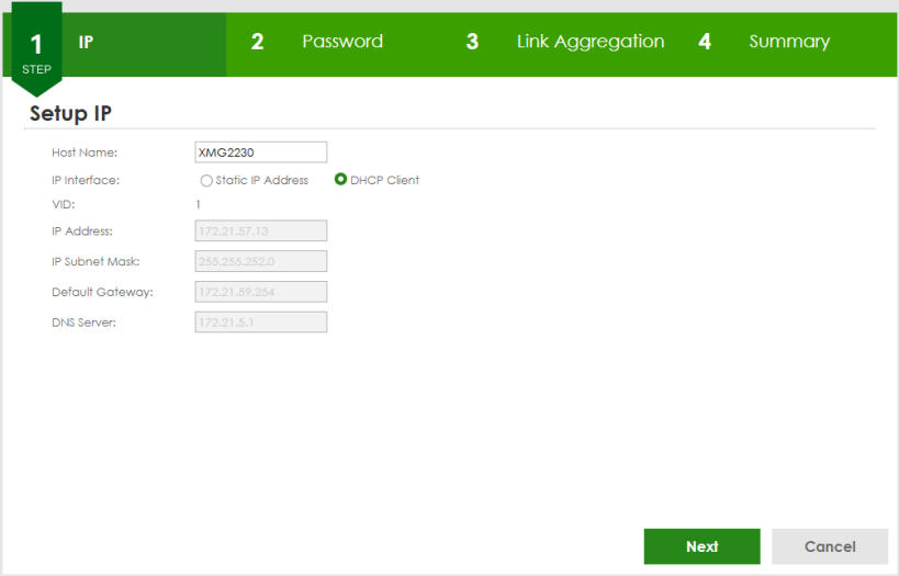

In Basic Settings, you can set up IP or DNS, set up your password, SNMP community, accept or skip the default Networked AV mode settings, and view finished results.
In order to set up your IP or DNS, please do the following. Click Wizard > Basic Settings > Next > Step 1 IP to access this screen.
Wizard > Basic Settings > Step 1 IP
Each field is described in the following table.
Label
Description
Host Name
This field displays a host name.
IP Interface
Select DHCP Client if the Switch is connected to a router with the DHCP server enabled. You then need to check the router for the IP address assigned to the Switch in order to access the Switch’s Web Configurator again.
Select Static IP Interface when the Switch is NOT connected to a router or you want to assign it a fixed IP address.
VID
This field displays the VLAN ID.
IP Address
The Switch needs an IP address for it to be managed over the network.
IP Subnet Mask
The subnet mask specifies the network number portion of an IP address.
Default Gateway
Type the IP address of the default outgoing gateway in dotted decimal notation, for example 192.168.1.254.
DNS Server
DNS (Domain Name System) is for mapping a domain name to its corresponding IP address and vice versa. Enter a domain name server IP address in order to be able to use a domain name instead of an IP address.
Next
Click Next to show the next screen.

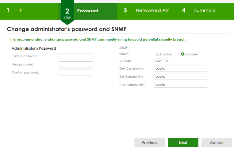

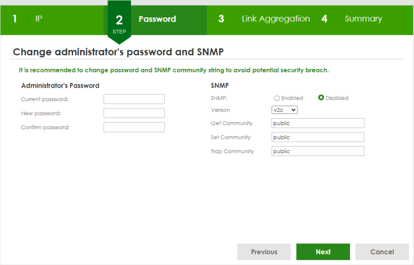

After clicking Next, the Password screen appears.
Wizard > Basic Settings > Step 2 Password
*The input string of any field in this screen should not contain [ ? ], [ | ], [ ' ], [ " ], or [ , ]. In the Password fields, [ space ], [ [ ], or [ ] ] are also not allowed.
Label
Description
Administrator's Password
New Password
Enter your new system password. The password rule when Password Complexity is disabled in SECURITY > Access Control > Account Security > Account Security is:
• 4 to 32 characters in length
The password rule when Password Complexity is enabled are:
• 9 to 32 characters in length
• Include at least three of these: numbers, uppercase letters, lowercase letters, and special characters (for example, ‘Ea5yPas5W0rd’)
• Cannot match your login username
• Cannot use the same character (case insensitive) or number three or more times in a row (for example, ‘777’, ‘AaA’)
• Cannot use four or more sequential keyboard characters (case insensitive) or numbers (for example, ‘qWer’, ‘1234’), and
• Cannot use the present password again.
*[ ? ], [ | ], [ ' ], [ " ], [ , ], [ [ ], [ ] ] and space are not allowed whether Password Complexity is enabled or disabled.
Confirm password
Re-enter your new system password for confirmation.
SNMP
SNMP
Select Enabled to let the Switch act as an SNMP agent, which allows a manager station to manage and monitor the Switch through the network. Select Disabled to turn this feature off.
Version
Select the SNMP version for the Switch. The SNMP version on the Switch must match the version on the SNMP manager. Choose SNMP version 2c (v2c), SNMP version 3 (v3) or both (v3v2c).
*SNMP version 2c is backwards compatible with SNMP version 1.
Get Community
Enter the Get Community string, which is the password for the incoming Get- and GetNextrequests from the management station.
The Get Community string is only used by SNMP managers using SNMP version 2c or lower.
Set Community
Enter the Set Community string, which is the password for the incoming Set- requests from the management station.
The Set Community string is only used by SNMP managers using SNMP version 2c or lower.
Trap Community
Enter the Trap Community string, which is the password sent with each trap to the SNMP manager.
The Trap Community string is only used by SNMP managers using SNMP version 2c or lower.
Previous
Click Previous to show the previous screen.
Next
Cancel
Click Cancel to exit this screen without saving.

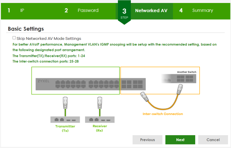

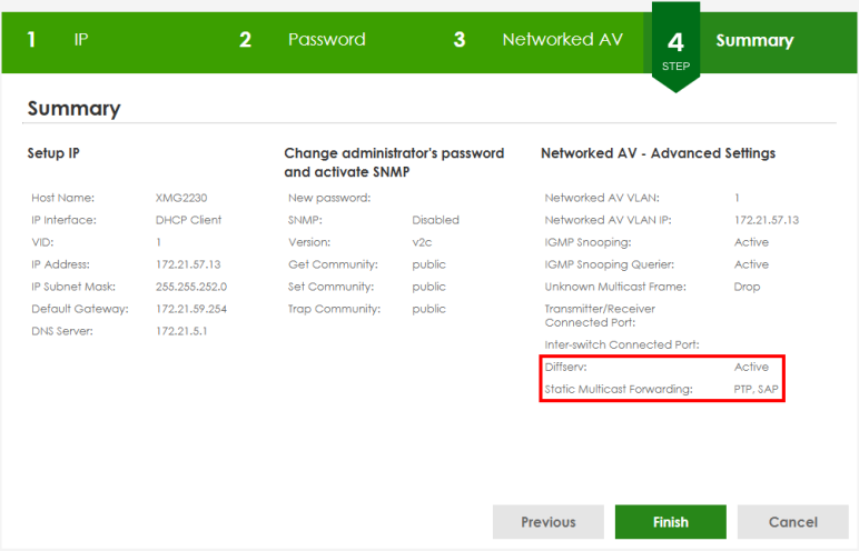

After clicking Next, the Networked AV screen appears.
Wizard > Basic Settings > Step 3 Networked AV
Label
Description
Skip Networked AV Mode Settings
Click this option to avoid using the basic default AVoIP settings. The default AVoIP settings can be seen in Step 4 Summary under Networked AV – Basic Settings.
Otherwise, clear the checkbox and follow the diagram for connecting RJ45 ports to audio and video equipment. The Inter-switch Connection is for connecting to another switch.
*Use the Wizard > Advanced Settings > Step 3 Networked AV to configure connections for non-Audio-Video equipment (for example computer, NAS) to the RJ45 ports.
Previous
Next

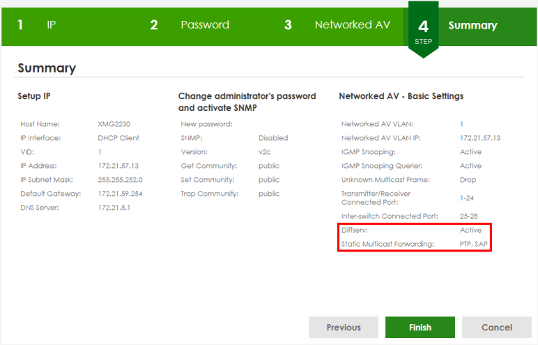

Wizard > Basic Settings > Step 4 Summary
*By default, Diffserv is Active and Static Multicast Forwarding is PTP to support the Dante (Digital Audio Network Through Ethernet) protocol.
Label
Description
Setup IP
Host Name
IP Interface
This field displays whether the WAN interface is using a DHCP IP address or a static IP address.
VID
IP Address
This field displays the Switch’s IP address for it to be managed over the network.
IP Subnet Mask
This field displays the subnet mask that specifies the network number portion of an IP address.
Default Gateway
This field displays the IP address of the default outgoing gateway in dotted decimal notation, for example 192.168.1.254.
DNS Server
This field displays the DNS (Domain Name System) for mapping a domain name to its corresponding IP address and so forth.
Change administrator's password and activate SNMP
New Password
This field displays asterisks when a new password has been created.
SNMP
This field displays whether the Switch acts as an SNMP agent.
Version
This field displays the SNMP version for the Switch.
Get Community
This field displays the Get Community string.
Set Community
This field displays the Set Community string.
Trap Community
This field displays the Trap Community string.
Networked AV VLAN
This field displays the VLAN ID for the AVoIP network.
Networked AV VLAN IP
This field displays the Switch’s IP address for it to be managed over the AVoIP network.
IGMP Snooping
This field displays Active when IGMP Snooping is enabled to forward group multicast traffic only to ports that are members of that group.
Otherwise, it displays Inactive.
IGMP Snooping Querier
This field displays Active when the Switch is allowed to send IGMP General Query messages to the VLANs with the multicast hosts attached.
Unknown Multicast Frame
This field displays the action to perform when the Switch receives an unknown multicast frame. It displays Drop when the frames are discarded. It displays Flooding when the frames are sent to all ports.
Transmitter/Receiver Connected Port
This field shows the Switch’s port numbers for connection to networked audio and video equipment.
Inter-switch Connected Port
This field shows the Switch’s port numbers for connection to another switch.
Diffserv
This field displays Active.
This means that IEEE 802.1p priority mapping in Quality of Service (QoS) is applied on the selected ports on the Switch. See Section 47.1 on page 328 for more information on QoS.
This field displays PTP, SAP.
PTP (Precision Time Protocol). The Switch allows the client devices to forward the PTP multicast packets to audio-over-IP devices to sync the time clock.
SAP (Session Announcement Protocol) for advertising multicast session information. The Switch allows AES67 (Audio Engineering Society 67) multicast packets to be directly forwarded to audio-over-IP devices.
See Section 45.1 on page 315 for more information on Static Multicast Forwarding.
Previous
Finish
Review the information and click Finish to create the task.
Cancel
Advanced Settings
In Advanced Settings, you can set up IP or DNS, set up your password, SNMP community, configure Networked AV service to a VLAN, select and assign port role, link aggregation (trunking), and view finished results.
In order to set up your IP or DNS, please do the following. Click Wizard > Advanced Settings > Step 1 IP to access this screen.
Label
Description
Host Name
You can enter a new host name here. Up to 64 printable ASCII characters are allowed except [ ? ], [ | ], [ ' ], [ " ], or [ , ].
IP Interface
VID
IP Address
IP Subnet Mask
Default Gateway
DNS Server
DNS (Domain Name System) is for mapping a domain name to its corresponding IP address and so forth. Enter a domain name server IP address in order to be able to use a domain name instead of an IP address.
Next
Cancel
Wizard > Advanced Settings > Step 2 Password
Label
Description
Current password
Enter the existing system password (the default password is on the label on the back of the Switch).
New Password
Confirm password
SNMP
SNMP
Version
Get Community
Set Community
Trap Community
Previous
Next
Cancel
Label
Description
Allocate networked AV service to a VLAN
Networked AV VLAN
Enter a number between 1 and 4094 to create a VLAN for the AVoIP network.
IP Address
(Optional)
You must enter a different VLAN ID in the previous field (Networked AV VLAN) to be able to assign another IP address for the Switch to be managed over the AVoIP network.
IP Subnet Mask
(Optional)
You must enter a different VLAN ID in the Networked AV VLAN field to be able to assign another subnet mask that specifies the network number portion of an IP address.
Select Ports and Assign a Port Role
Select all ports
After you create a VLAN, select the ports to be assigned to the Networked AV VLAN.
Select all ports to assign the same role to all ports.
You can select a port by clicking it. Then click any of the following:
Click Tx/Rx to assign the ports for connecting to audio and video equipment.
Click Inter-switch to assign the ports for connecting to other switches or gateway.
Click Management to assign the ports for connecting to non-Audio-Video equipment (for example, computer and NAS) if your Networked AV VLAN is different from management VLAN.
Link aggregate
Select this option to aggregate multiple port bandwidth if you are connecting to another switch. Link aggregation (trunking) is the grouping of physical ports into one logical higher-capacity link.
Previous
Next
Cancel
After clicking Next, the Summary screen appears.
Wizard > Advanced Settings > Step 4 Summary
Label
Description
Setup IP
Host Name
IP Interface
VID
IP Address
This field displays the Switches’ IP address for it to be managed over the network.
IP Subnet Mask
Default Gateway
DNS Server
New Password
SNMP
Version
Get Community
Set Community
Trap Community
Networked AV – Advanced Settings
Networked AV VLAN
This field displays the corresponding VLAN ID’s IP address for the AVoIP network.
IGMP Snooping
This field shows the Switches’ port numbers for connection to networked audio and video equipment.
Inter-switch Connected Port (Link Aggregation)
This field shows the Switches’ port numbers for connection to another switch.
Previous
Finish
Cancel
Standard Mode Wizard
• Basic – to configure the Switch IP address, DNS server, system password, SNMP community and link aggregation (trunking).
• Protection – to enable loop guard and broadcast storm control on the Switch and its ports.
• VLAN – to create a static VLAN, assign ports to the VLAN and set the ports to tag or untag outgoing frames.

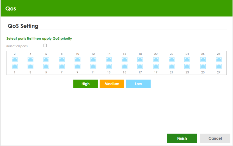

• QoS – to determine a port’s IEEE 802.1p priority level for QoS.
*When in Cloud mode, do NOT use the Wizard to configure the Switch.
Setup Wizard

In order to set up your IP/DNS, please do the following. Click Wizard > Basic > Step 1 IP to access this screen.
Label
Description
Host Name
This field displays a host name. Enter a string to set a new host name.
The host name should not contain [ ? ], [ | ], [ ' ], [ " ], or [ , ].
IP Interface
Select Static IP Address when the Switch is NOT connected to a router or you want to assign it a fixed IP address.
VID
IP Address
IP Subnet Mask
Default Gateway
DNS Server
Next
Cancel

Get Community
Set Community
Trap Community
Previous
Next
Cancel
After clicking Next, the Link Aggregation screen appears.

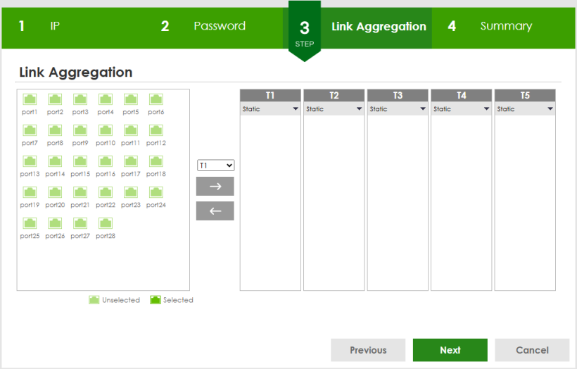

Wizard > Basic > Step 3 Link Aggregation
Label
Description
Link Aggregation
T1-Tx
Click the arrows to add or delete icons located on the left to desired preference.
Select Static if the ports are configured as static members of a trunk group.
Select LACP if the ports are configured to join a trunk group through LACP.
Previous
Next
Cancel

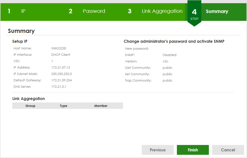

Wizard > Basic > Step 4 Summary
Label
Description
Setup IP
Host Name

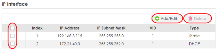

IP Interface
VID
IP Address
IP Subnet Mask
Default Gateway
DNS Server
New Password
SNMP
Version
Get Community
Set Community
Trap Community
Link Aggregation
Group
This field displays the group number.
Type
This field displays Static or LACP of this group.
Member
This field displays the members of this group.
Previous
Finish
Cancel
Protection
In Protection, you can set up loop guard and broadcast storm control.

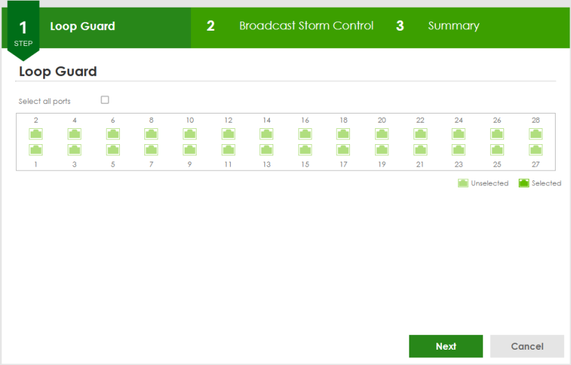

In order to set up loop guard, please do the following. Click Wizard > Protection > Step 1 Loop Guard to access this screen.
Label
Description
Loop Guard
Select all ports
Select all ports to enable the loop guard feature on all ports.
Next
Cancel
After clicking Next, the Broadcast Storm Control screen appears.

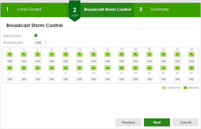

Wizard > Protection > Step 2 Broadcast Storm Control
Label
Description
Select all ports
Select all ports to apply settings on all ports.
Broadcast pkt/s
Specify how many broadcast packets the port receives per second.
Previous
Next
Cancel

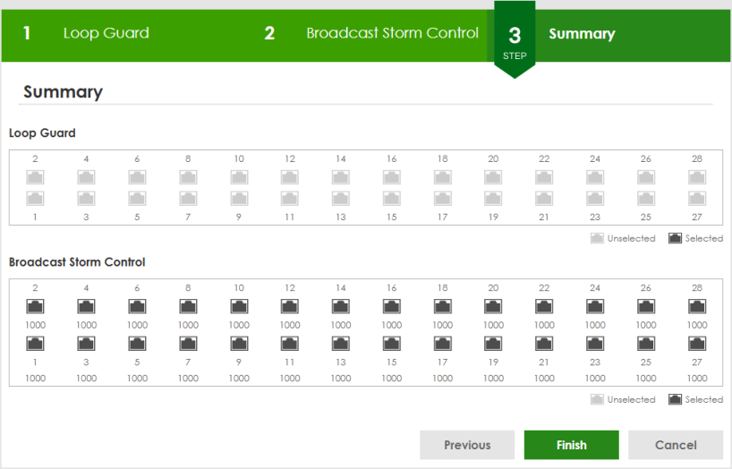

Wizard > Protection > Step 3 Summary
Label
Description
Summary
Loop Guard
If the loop guard feature is enabled on a port, the Switch will prevent loops on this port.
If the broadcast storm control feature is enabled on a port, the number of broadcast packets the Switch receives per second will be limited on this port.
Previous
Finish
Cancel

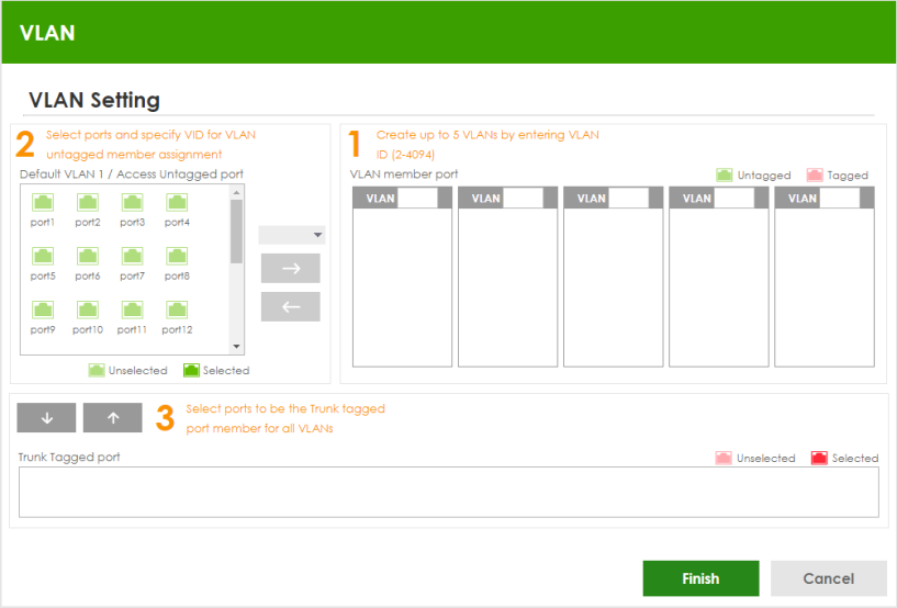

VLAN
In VLAN, you can create VLAN, and tag VLAN settings.
Click Wizard > VLAN > VLAN Setting to access this screen.
Label
Description
VLAN Setting
Default VLAN 1 / Access Untagged port
After you create a VLAN and select the VLAN ID from the drop-down list box, select ports and use the right arrow to add them as the untagged ports to a VLAN group.
VLAN member port
VLAN
Type a number between 2 and 4094 to create a VLAN.
Trunk Tagged port
Select ports and use the downward arrow to add them as the tagged ports to the VLAN groups you created.
Finish
Cancel
QoS
In QoS, you can create QoS settings.
In order to create QoS settings, please do the following. Click Wizard > QoS > QoS Setting to access this screen.
Label
Description
QoS Setting
Select all ports
High
Select ports and click the High button, so they will have high priority.
The port’s IEEE 802.1p priority level will be set to 5. Use the PORT > Port Setup screen to adjust the value.
Medium
Select ports and click the Medium button and, so they will have medium priority.
The port’s IEEE 802.1p priority level will be set to 3. Use the PORT > Port Setup screen to adjust the value.
Low
Select ports and click the Low button, so they will have low priority.
The port’s IEEE 802.1p priority level will be set to 1. Use the PORT > Port Setup screen to adjust the value.
Finish
Cancel

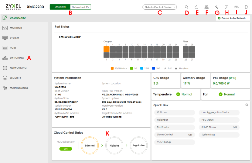

Web Configurator Layout
The DASHBOARD screen is the first screen that displays when you access the Web Configurator.
The following figure shows the navigating components of a Web Configurator screen.
A – Click the menu items to open sub-menu links, and then click on a sub-menu link to open the screen in the main window.
B, C, D, E, F, G, H, I, J, K – These are quick links which allow you to perform certain tasks no matter which screen you are currently working in.
B – Click this icon to switch between the Web Configurator’s Standard or Networked AV mode.
C – Click this icon to go to the NCC (Nebula Control Center) portal website.
D – Click this icon to search for specific configurations or status you are looking for. Enter the keywords and click the result link. This will direct you to the specific configuration or status page.
E – Click this icon to update the information in the screen you are currently viewing.
F – Click this icon to save your configuration into the Switch’s non-volatile memory. Non-volatile memory is the configuration of your Switch that stays the same even if the Switch’s power is turned off.
G – Click this icon to display the Setup Wizard that contains the Basic, Protection, VLAN, and QoS setup screens.
H – Click this icon to display web help pages. The help pages provide descriptions for all of the configuration screens.
I – Click this icon to go to the Zyxel Community Biz Forum.
J – Click this icon to log out of the Web Configurator.
K – This displays the Nebula Cloud Control Status. The ON/OFF switch displays if NCC Discovery is enabled. If a status circle turns Orange, it means the Switch is unable to connect to NCC. Hover the mouse over the status circle to check the diagnostic message. You can also click the ON/OFF switch to go to the SYSTEM > Cloud Management > Cloud Management screen and check the diagnostic messages. See Table 47 on page 158 for more information.
In the navigation panel, click a main link to reveal a list of sub-menu links.
The following table describes the links in the navigation panel. The navigation panel varies depending on the product model you use.

Tables have tool icons for working with table entries as shown next. You can select one or more entries, or select the checkbox in the heading row to select all entries. Use the tool icons to modify the selected entries.
Working with a Table
The following table describes the most common table icons.
Common Table Icons
LABEL
DESCRIPTION
Select an entry’s checkbox to select a specific entry. Otherwise, select the checkbox in the table heading row to select all entries.
Add/Edit
Click this to create a new entry or edit a selected entry. A configuration screen where you can add a new entry or modify the settings of the selected entry will open.
In some configuration screens, the Add/Edit button is replaced by the Edit button. This means you can only edit the existing entries in the table.
Delete
To remove entries, select the entries and click Delete.
When viewing a list, you can click on an index number to view more details about the entry. If the list has more than one page, click the arrow button to navigate to different pages of entries.

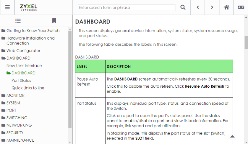

Help
The Web Configurator’s online help has descriptions of individual screens and some supplementary information.
Click the Help icon on a Web Configurator screen to view an online help description (shown as below) of that screen.
Online Web Help
